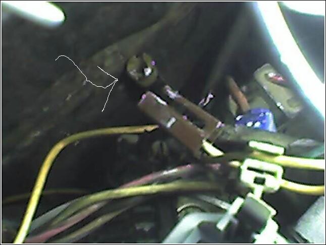

    I am restoring a rough 86 (late) 4+3 car. after maybe figuring out the egr/air/ vacuum hose locations and routing, I noticed coming up along the firewall to under the distributor, there is what looks like a hose or tube that is either broken / or is only one part of a connector. Can anyone identify this? thanks

    Looking at my '89 service manual, I'd guess is is the connection for the vacuum line that supplies vacuum for the HVAC system, Should run from the vacuum resevoir in the inner fender foreword of the wheelhouse back along the lower inner fender and behind the power brake booster to a connection at the rear of the engine providing a vacuum source via a line off the pass side of the plenum. I believe this was common 86-89.
