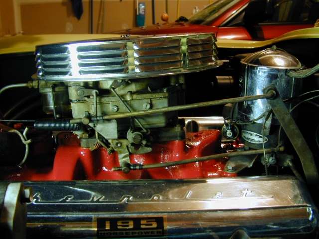

        This is my 55 Corvette one that is dated ,NCRS should make people remove the filter He! He!
        • Dave Suesz
          Heck Roy, do
          you still have the OE "solid" filter element? I do! That's a lot easier to spot than the casting date!

              Re: Heck Roy, do
              Nice RED engine you got there BUD! it's a no no in NCRS and a black Carb spring??
              • Dave Suesz
                Well,
                the spring is original, although it has been cleaned so many times I doubt any trace of original paint remains. I consulted many sources regarding color when I repainted that engine, which is partly original. You, Noland Adams, and Ken Kayser would top the list. If the opinion of these three gents is not sufficient for the NCRS, I'd say the NCRS is a dead loss. Unless the judging guide has changed since I bought one, I still disagree with them about 55 mufflers.
