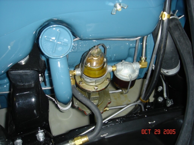

        • david boller
          Re: 54 fuel pump
          If you do not mind, I will email a pic to you.

            • Michael L.
              • July 31, 2005
              • 562
              Re: 54 fuel pump
              Nice looking engine and frame. Clean enough to eat off of!
