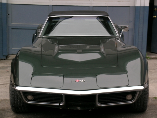

                Here is a pic of the car I am in the middle of surgery with. She was built 2nd to last day of 69 production.
