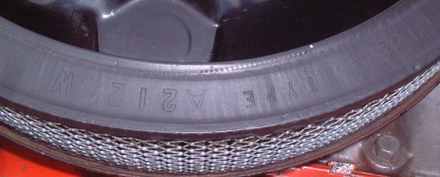

        • Nick Culkowski
          Re: 67 AC A212CW air filter
          When I ran across this original element I was suprised to learn that there was no ink on originals, as many judges believe. Most judges that I judge mech with still insist on telling owners about removing the "Best way to" portion of the ink to make it more like originals. I guess it does to some degree. I have only seen a few originals and none had white ink on it...

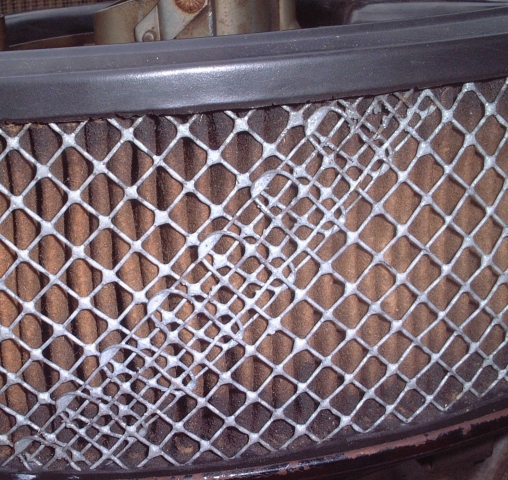

          • Nick Culkowski
            Here is a side view. Note the wire and finished edges.
            • Peter L.
              • May 31, 1983
              • 1930
              Nick - You're the man!!!!!!! Nice piece and excellent photos. The side view show how "elegant" the soldering was where the ends came together on the originals. Unfortunately, many of the '67 owners and judges have not seen the "real" thing. Hopefully they all see you post. Again, as I aways say "product knowledge" is a critical element to the hobby. Bottomline is, as far as I know is, no one is making reproductions like the real thing. In the case of original AC A212CWs I'm like Joe Lucia, they are not for sale. Pete
