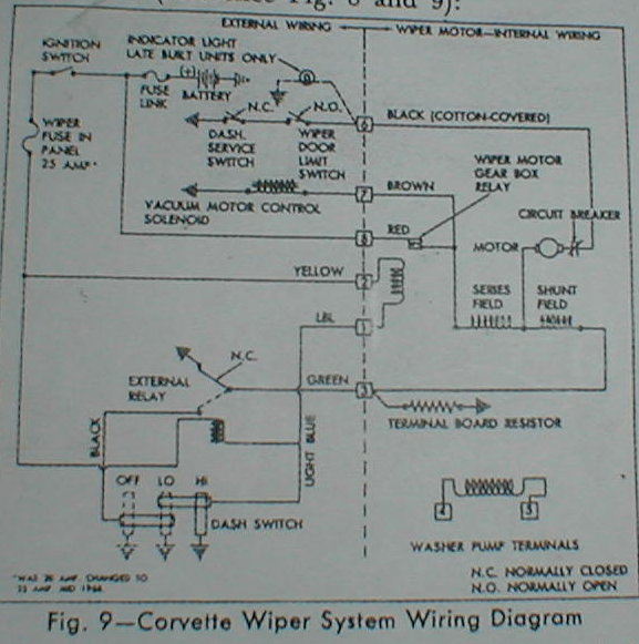

                  This applies to my original owner 68's wiper switch. Discovered many years ago that when the car was parked and not being used that if the windshield wiper switch was accidently turned on and turned off that something was activated and the battery would be dead in a few days. From that learning experience, whenever the wiper switch is accidently turned on I start the car and properly cycle the windshield wipers to off. Cleaning the dash or inside windshield sometimes the windshield switch would get activated acccidently.
                    • 15573
                    68 and up wipers
                    You are lucky the battery went dead. Doing what you describe on a 1968, or shutting off the car while the wipers are on the windshield (not parked) on any 1968-1972 leaves the wiper motor energized. More than one early C3 has caught fire under these circumstances. This was one of our stronger points in favor of judging points for the battery cut-off switch.

                          • 15573
                          Re: 68 and up wipers
                          The 1968 wiper motor is a one-year only item, I believe, in part as an effort to correct this issue, but some form of the problem or a similar problem persisted at least to 1972 and I suspect beyond that. I have not made an effort to track the circuit that provides power to the relays and/or resistors under the motor/pump cover -- I can tell you in judging I have observed a large number of deformed covers due to something underneath heating the cover. I have also observed about half dozen burned Corvettes in which the fire appeared to start in the wiper motor area -- and in all cases the wipers were on the windshield and the car caught fire while parked with the keys removed.
                          I think the simple solution is to disconnect the battery when the vehicle is parked.

                            • Bryan K. Montford
                              Here is the 68 wiper motor wiring diagram. As you can see, the red wire going to the wiper motor is connected ahead of the ignition switch making it hot all the time to the latch relay in the wiper motor. That's why it is important to have the wipers cycled thru to be in the proper off condition.
                              Bryan
