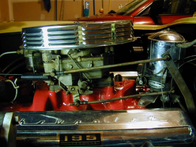

    Well, the
    intake manifold on #518 (built approx Aug 12, 1955) is code F235 (June 23, 1955). This is known to be the original manifold, since the car has been in the family since new.
    What engine do you have now? Are the external accessories (manifolds, shields, etc. correct? Is it painted the correct Chevy Red?

          • Dave Suesz
            Well, the
            block is about a month earlier than the manifold, but it is known to not be original (I installed it with my Dad in 1971). The original died in 1964 when a piston broke. For years it had a 283, but we got a 55 engine and had this one built. I must say, a 265 with a Duntov cam runs a LOT better than that 283 did. If you ever get the urge, go for it, the 55 block is completely unique, and unmistakable, as is the intake manifold. Usually not real expensive, either.

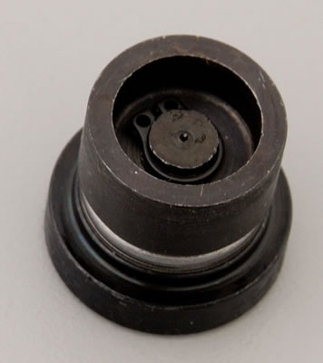

                    Coupla 55 notes...
                    Use an OE or good repro of the Duntov cam, it really adds to the authenticity of the engine. Use the 4" dia "off-road" style mufflers, it's what the 55 was supposed to have, and it sounds great with a 265 power pac engine. Be careful with the cam, it should have a notch in the rear bearing, to supply oil to the valve train. Install a "thrust nose" on the front of the cam, even a slight bit of timing chain wear can allow the cam to walk forward and cut off the valve oil supply. Ask me how I know :o)

                      • Karl L.
                        • February 1, 1977
                        • 174
                        Re: Coupla 55 notes...
                        Thanks Dave,
                        I've been mulling over a Cam. I know about the oil groove. I'm in the dark
                        about a "Thrust Nose".
                        Thanks again for the Input. I'll try the Registry's you gave me.
                        Karl.

                          • Dave Suesz
                            Looks like this...
                            Do not assemble you engine without one. Not having this $8 part cost me a $500 towing bill once. Goes on the front of the camshaft, keeps it from drfting forward.
                            Summit, Jegs, any speed shop should have this.
