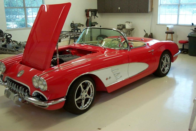

              You want to stay away from white on epoxy floors. ALL epoxies will yellow with exposure to UV, and you will be unhappy after a year or so. Urethanes yellow less, but they can still be a problem. I have had Armorseal 1000 down for several years now. I chose a very light beige, and it still shines pretty good, as you can seein the pic. I will topcoat it later this year, just to freshen it up. You can have it made in pretty much any color you desire unlike so mnay floor coatings where you get about 5 color choices. I treat my floor like crap, and it still holds up well. About the only real wear spot is where my rolling stool sits in front of my workbench.

                        • Joel Falk
                          Re: Garage floor coating product experience
                          Is there a floor in that picture? I can't take my eyes off your car!
                          I'm usually not much for the resto mods but I really like what you have done.
                          • John McGraw (31656)
                            • January 1, 1999
                            • 8
                            Thanks Joel,
                            I like restored Corvettes and resto-mods both. The 59 was a total basket case with a rusted-out frame, no engine, trans, or rearend. I bought it for the boxes and boxes of NOS parts that came with it, as I was restoring a 60 at the time. I finally got tired of this hulk of a body sitting in storage, and decided to do something with it. It was pretty rough, but it cleaned up nice.
                            I am doing a midyear convertible right now that was a real hulk as well. The only panels that I did not replace on it were the doors, body tub, and decklid. It should be on the road by late spring if I can find time to work on it.
