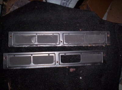

    There are two style doors. One has a solid plate on each side the other has two windows in each side. I can't tell from the aim what ia what. Is one style for cpe/cvt? or rear vent or air cond.??

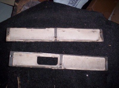

        Here's a pic of the ones from my '68 A/C convertible. I just removed them yesterday.
        Good luck,
        Anthony

          THIS CONTRIDICTS WHAT gEORGE SAID. mABEE The cpe has a solid plate. I have 69 air cvt apart and a 68 non air cpe. I have them mixed up??

            These are what mine look like (Feb. Built, 68 Coupe, NO A/C)
            Steve

                I should have clarified my photo a little more. These vents are not sealed, they actually open towards the back of the car.
                There was a gasket around the outer edge, but the slots were free to move & came out as 4 individual pieces (what was left of them).
                As you can see from this photo, there are only retainers on the top, allowing the bottoms to move to the rear.
                My car is a '68 convertible with A/C built January 24, 1968.
                Hope this helps, but it will probably cause more confusion,
                Anthony
