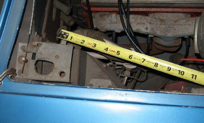

                  I have a 67 factory air car that happens to have its front end up in the air right now with the passenger side splash pan removed, so I decided to go out in the garage and look at things with the added advantage that my hood is already open. Wow, what mess trying to figure out how to get to the release lever on the passenger side!
                  However, I came up with a method that worked quite well but it is kind of like threading a needle.
                  From under the car I was able to clearly see the release lever that needs to be pushed forward. I had an available three foot section of half inch steel rod that I was able to push up from underneath into the position shown in the attached photo (top view). Since I can only attach one photo, the second URL below will take you to a photo that shows where the rod came out underneath:
                  You can get an idea of the angle by looking at the relative location of the exhaust pipe and the idler arm that appear in the bottom view photo.
                  What made this work was that the rod was resting against the insulated pipe that comes out of the top of the A/C evaporator case, so the rod could pivot against that point. If you study the top view photo carefully I think you will see what I mean about the pivot point. After the rod was threaded into position, pushing the bottom end of the rod toward the back of the car caused the top end to move forward and push the release lever forward.
                  The piece of steel rod that I used was just what I had available, but I think the ideal piece would be 3/8 inch and maybe two feet long. You may find that some of your hoses are routed differently and may need to be moved aside, but if you can get a rod in the location shown, I think you will be able to relese the latch.

                    I put up some pictures on CF the other day for a guy whose wife is going to make his life miserable this weekend. If you can't get it with Joe's suggestion, you might try that. You might use someone underneath to guide a hook into place.

                      Joe & Mike
                      Joe I am forever indebted to you---I got it open in less than five minutes using your method and the photos that Mike posted were also helpful. 3/8 rod by 30 inches in length was perfect. With an A/C sytem it is not possible to see the lever. Of course now that the hood is open and looking from the top side it looks like it should be simple--it ain't.
                      Last evening I was contemplating the use of my sawsall, but you guys advice and the bar saved the day for me.
