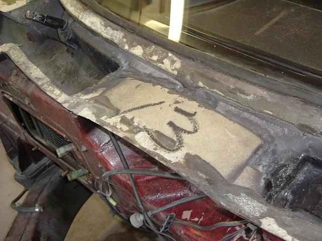

              How about here?

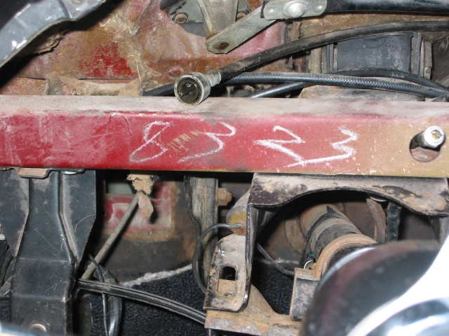

                            here's a four digit job number of sorts, on a 65 AOS dash cross brace:
                              Re: C2 Body Number
                              Mark -
                              Yup, the cowl & dash subassembly was also marked, as shown in your photo, as that assembly had MANY different option condition details specific to that particular car, not the least of which was A/C; the number was covered up when the front clip was bonded on.
