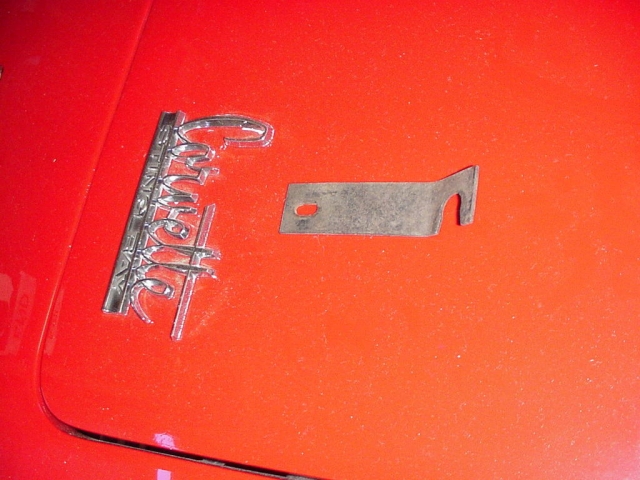

    Need some help
    I discovered this bracket below my radiator just laying loose. I have a 66 small block. I replaced the radiator 2 years ago but do not rememer this. Anyone recognize what it is?

    Re: C2 mystery bracket
    That is a support bracket for a headlight motor. The hooked end goes in a rubber bushing.
          If your headlight housing still rolls over then it wasn't connected to the motor. The hole is suppose to attach to the motor with a hex screw that also grounds the motor. Check to see if one of your headlights doesn't roll over. If one doesn't work then you know which one the bracket is off of.
            Joe,
            Excellent catch! I am looking at UPC 12 A3. I just got a mirror out and I see one is loose from the grommet and the other is in my hand!
            I obviously have not tried to raise the headlights. What is the best way to access for repair. Do I need to remove the grill or can it be done from the top.
            Randy

                    Guys,
                    Thanks for all the tips. Got the bracket back in today.

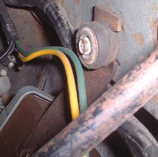

                    • Nick Culkowski
                      Somebody got lazy installing this one. The end on the side with the rubber grommets should have been in the slot around the circumference
