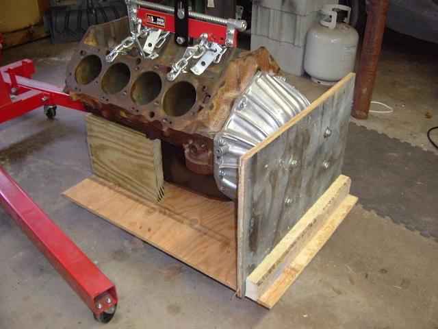

    This is as cheap as you can get.

      If you are just storing the engine then get/make a stand such as that pictured in the other post.
