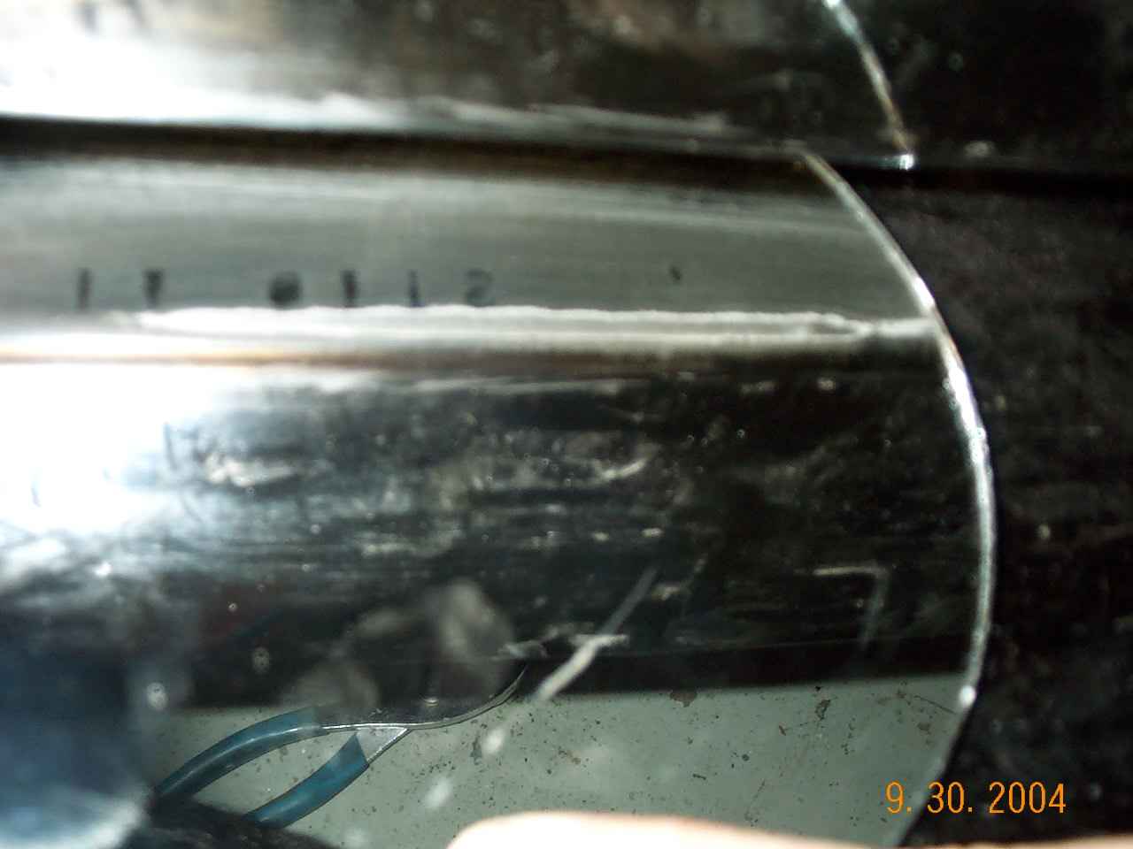

            It is definitely a needle-in-a-haystack search depending on the frame condition. I loosened the body bolts on the left side and used wooden wedges to add about 1/2" to the gap between the body and frame on my '61. Then with fine sandpaper, steel wool and wiping with some WD-40 to increase resolution, I was able to make out the numbers. It took manipulation of the light, mirror and camera position to get the best contrast. Pick a warm day to lay on the garage floor because you will be spending some time down there!
            I think the numbers are about 1/4" and are more towards the inboard side of the frame rail. As others suggest you might be able to feel a slight depression in the frame where the stamp was struck.
            The photo shows my numbers from under the driver's seat area. Note that because of the mirror the numbers are reversed but the photo provides a relative position (I later flipped them on the computer). Also notice that one of the digits in the center is completely missing. That is due either to previous corrosion and/or subsequent sanding (it was frame-off restored some years ago) or just stamped lightly in the first place.
            If you can find the numbers and they match it is a great relief. I know that I felt better after I proved to myself that everything matched up.
            Good luck and happy hunting!
