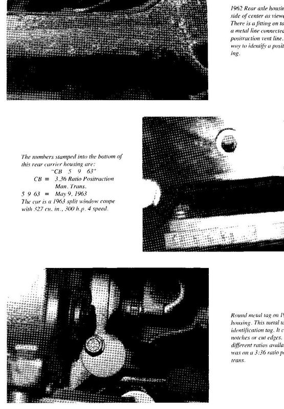

    John, if you have the Corvette Chassis Restoration Guide by Joseph A. Tripoli, Jr. Take a look at page 54 at the bottom.
    Harry

          OK, I'll scan it in and send it to you.

            The guide is in black and white and it is tough to scan. He is what I could get.
