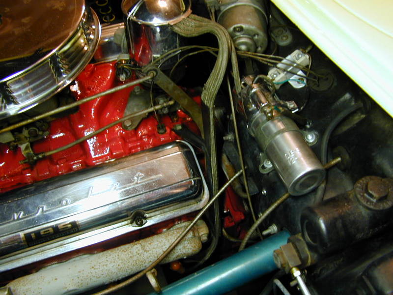

                    • Dave Suesz
                      The advance
                      "can" is the 1116098, not just an original, the original. The engine block has been replaced, but since it was in the family the whole time, all the accessories were saved and installed on the replacement. The only detail item missing, and had been missing since I was a small child, was the big Mallory capacitor on the distributor, which is part of the RFI shielding. Found that one NOS fairly inexpensively. "Corvette" suppliers offered them to me for around $200, but I got lucky and paid about 1/10 of that. I am very glad to have the braided covers for the distributor and coil lead wires, as far as I know these are not reproduced. It might be possible to find braid that small to make them. The ignition wires are available, along with the braided covers, but I still have 8 of the original 9 covers. Some fool in a service station threw one away in like 1963, so I had to get some braid to re-cover one wire. Sadly, the 55 repro wires are not available without the shields.

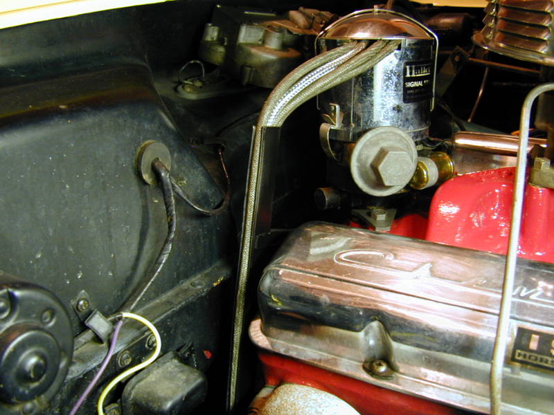

                      • Dave Suesz
                        Yeah, red, and the wires
                        I mentioned connceting the coil and distibutor can be seen here.
                        I got weird conflicting advice from local restoration shops concerning 55 (and 56) engine color, but eventually I heard from you, Ken Kayser, and Noland Adams, and I was all straightened out after that :o)
