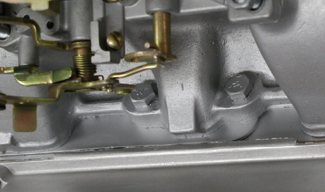

        No, the shape was different too.
        Often, the factory hit the area between the head and intake with silver paint to hide any raw iron color from the intake side of the head. That's one way to hide the color of your gasket, but any judge will be able to discern the difference in shape.
        See picture below for how I did it on a 1966 350hp motor.
        Patrick
