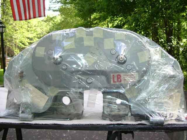

      • Mark S. Lovejoy
        Re: C2 dash cluster labels
        LB, '65 L78 (396, 425).

              Re: C2 dash cluster labels - '65 L78 & L76
              isn't the 65 396 (L78) dash configuration the same as the 65 365 (L76)?
              and thus, wouldn't the same cluster broadcast code (that's what these two-alpha stickers are, in effect) be used for that 6500 redline, 80 lb oil pressure gauge cluster in 65?
