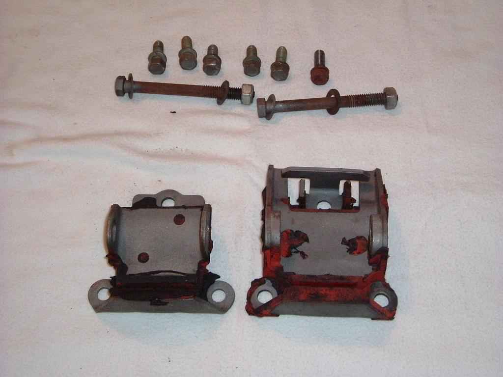

          Did all C2's use the Marsden type lock nut or were other locking type nuts used as well?
          I have what I believe are original motor mount fasteners and while the nuts are locking type, they are not the split or Marsden type. The JG states split nuts, but I wonder if more than one type were installed.

            Re: C2 engine mount "split lock hex nut"?
            Hello Mark;
            Great picture.
            Well, we all know the General was just putting cars together.
            Hope we get more opinions and possible answers.
            Thanks, Ray

                I'm on a business trip now, but I think the picture you posted looks like the through bolts from LI Corvette.
                Thanks for the help, Ray
