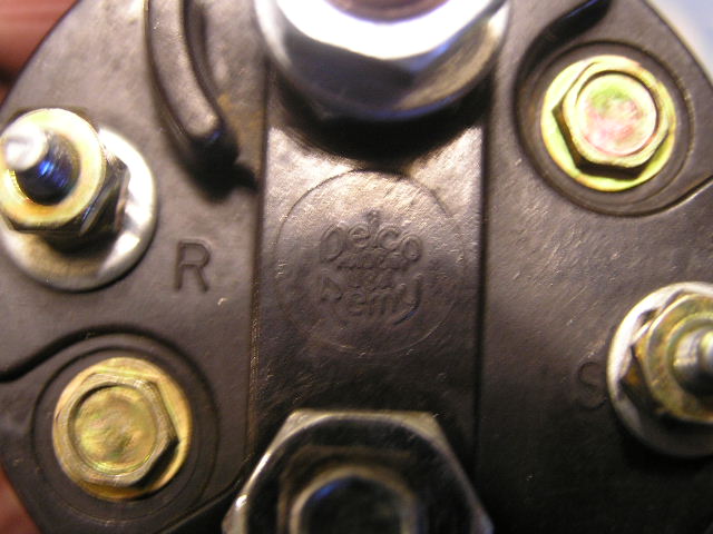

    In the Tech Manual it states the cap on the solenoid is dark brown. I have found one with this part # (1114356) and a black solenoid cap. Could this be correct for a 427/390? VIN is around 110500. Thanks.
  • Brian #46951
    Re: 1967 Solenoid
    Oh, and here is the top of the cap. Could the "R" be a replacement cap?

      That is an original solenoid for your 427/390. The cap is black as well as the solenoid itself.

        "R" is the ballast resistor connection point. "S" is the ignition switch connection point.

          The 'S' and 'R' marks are as Steve says--different wiring connection points for supplying ignition power during engine cranking vs. non-cranking. Auto electric guys typically refer to them as the START and RUN terminals...

            I have never seen an original GM #1114356 with a dark brown cap. Perhaps some were made, but I've never seen one that I thought was original. However, I know that at least some, if not all, of the 356 solenoids used during the 67-69 period used black caps.

              Joe, Maybe the Tech Manual needs to be changed. Page 136 of the Red (4th Edition) manual states "a dark brown Bakelite material." I have been told there was also part # 1114458 used. Could that have been dark brown? If the manual is incorrect, who would we notify?

                I don't think that a GM #1114458 was ever originally used on a 1967. I don't even think that solenoid part number even existed at that time.
                The dark brown cap was GM #6258043. I don't think that it was used on the GM #1114356 solenoids until about 1971 or 1972. Even then, I don't think that it was used on all such solenoids.

                  Starter looks like a goat hill or Ebay special *NM*

                    Phil, why do you feel that way? More specifics would be appreciated. Thank you.

                      Brian it seems like you testing the waters, I think you know what you have. It looks to me like it been restamped, and thats what you get from those places. Iam not trying to hurt anyone, you asked, I give my thoughts. Phil 8063

                          The terminology START works for me, but RUN doesn't in that this terminal has no power in a run condition....unless they are refering to the starter itself running....
