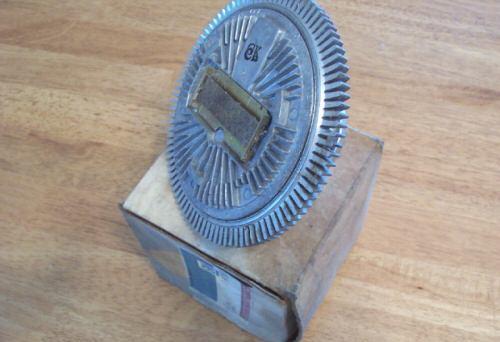

        • Frank Bernier
          Re: 69 vette - Fan clutch - p/n ?
          about this clutch ?
          is this a 3937771
          or maybe 3916141
          -Frank
            • 43193
            Frank------
            The clutch pictured is a Sweitzer-manufactured version of the GM #3916141.

              Looks to me like it's identical...
              to a Ford C4SA-B fab clutch as used on mid-60 era Ford BB's... What's embossed on the side of the drive hub?

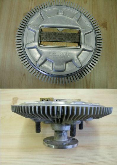

                does anyone have a picture for a 3937771 fan clutch .... what does it look like ?
                  • 43193
                  Re: Looks to me like it's identical...
                  Frank----
                  It looks like this
                    • 43193
                    Here's a photo of the rear of the 3937771
                    • Jack H.
                      • April 1, 1990
                      • 9906
                      Side photo is the judging telltale... The center of the face surrounding the bi-metal actuator has aluminum fins that protrude upward to almost the same height as the surrounding outer ring. There's another, similar, Schwitzer fan clutch that looks identical with the exception being the fins in the face center are MUCH lower in profile and fall well below the plane of the outer ring.
                      Last, you can't see from just Joe's picture. But, note this is a 7-inch (width) clutch vs. the smaller OD (6-inch) clutch units used on mid-year and base engine Shark cars...
