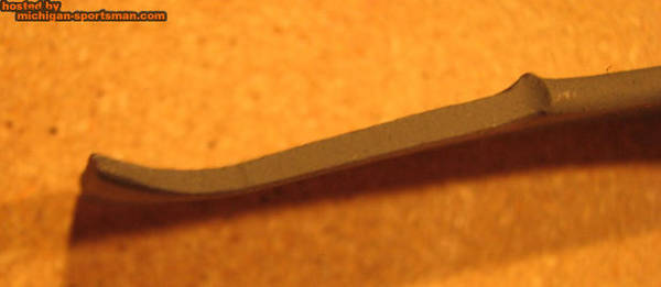

      Re: 1970 9 leaf spring question
      Here are photos of a 67 spring. Can only assume its the same as a 70.
      Note that top leaves are flat when the spring is at rest, while your '81 has all arched leaves. A far as the clamps go, I believe you can remove them with no ill effects.....
            Steve,
            "To me" this 67 spring appears to be a replacement. The ends of the leaves are turned up, but do not taper the way I would expect an original to taper in thickness.
            Also, the center bolt and nut should be black. Once the spring is fully assembled, the extra threads of the bolt are "clipped" off.
            Patrick
              Patrick, I hate to disallusion you, but this is the original spring out of my 67, with the original bolt. Granted, I didn't re-blacken the bolt. Some of the shorter leaf inserts are also original, I cut a few of the long ones that were worn on the ends shorter for use in those positions.
                    Steve,
                    It takes more than a picture to disillusion me. I suspect it's the camera angle on the leaf ends.
                    I went downstairs and pulled out one of mine. It's tough to get a good picture, in focus, of an end.
                    See below.

                      '67 spring
                      Steve,
                      The ends on your spring look correct to me. They are clearly different than the ends on the current Eaton-Detroit repro spring, which have a sharp bend in them.
                        Here are a couple of more photos of my original 67 spring.
                          • 11608
                          Thanks Steve. Your "left rear" picture shows the end configuration the best. Definitely original, and sorry if you took offense.
                          I went and looked at my spare replacement spring (non-Eaton but also non-original), and the ends are relatively straight but with a slight upturn. From the right (wrong?) angle, the ends could look just like the ones in your first photo.
                          Nice job on that chassis, too!
                          Patrick
                            • 11608
                            Re: '67 spring
                            Gary,
                            I have a spring from another supplier with ends that are slightly straighter than original. I thought that Steve's first picture looked more like that. It definitely is not an Eaton spring.
                            Patrick
