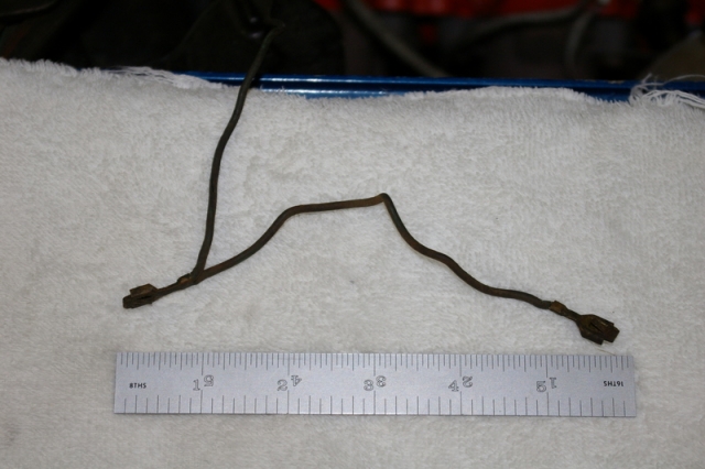

                  • tom444634
                    Re: Thanks Guys ...
                    Patrick,
                    Below is a picture of the one on my 71 (early Sept 70 build) LS5.
                    The wires are dark green and as you can see, the extension wire is about 6" long. The plastic connector housing is MIA.
                    Tom
                    • Pat M.
                      • April 1, 2006
                      • 1575
                      Re: Thanks Tom
                      Thanks so much, Tom. Can't get much clearer than that.
                      Patrick Moresi #45581
