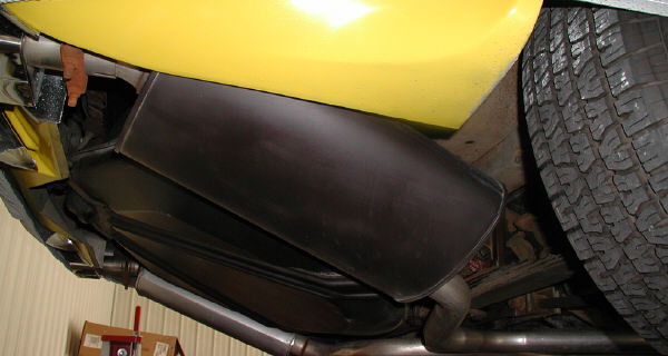

                        Re: Search the archives...
                        This is a 72, not a 65, but you get the idea. It's what I did with my aluminized exhaust to get the right look.
                        Patrick
