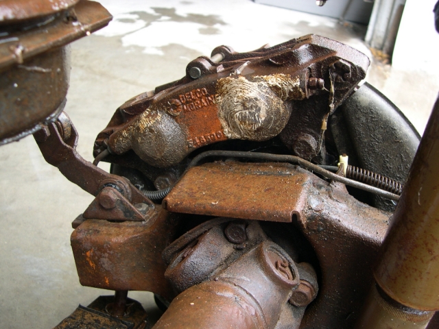

              Here's the white and orange paint daubs on the left rear brake caliper.

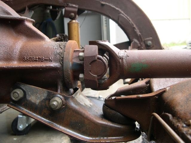

                Differential to driveline.

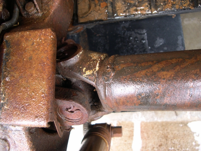

                  White daub on outboard passenger half shaft.

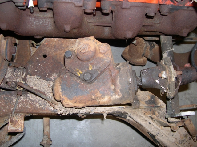

                    Steering box: yellow daub.

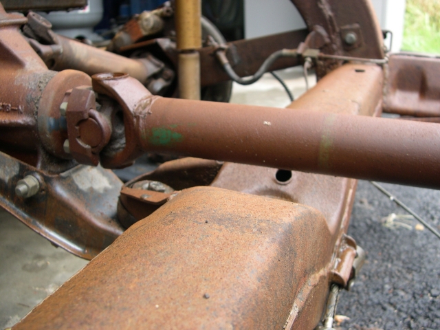

                      Driveshaft ring: lime green.

                        There's also a remnant of an orange daub on the inner side of the left trailing arm. You can just see it in the photo.
