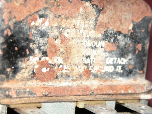

    This is a picture of my 61 voltage reg. 1119, 001E, 12VN, 1L stamped in the base. Does anyone have a clear picture of the correct reading of the silk screened instructions? As you can see, mine is only partially visible.

    You'd have to check with John Pirkle http://www.johnpirkle.com but to my limited knowledge, original regulators from GM/AC Delco did not have any embossed instructions on the side of the cover. This regulator might be an aftermarket/rebuilt unit (ie: from Western Auto or some other re-manufacturer)

      It's stamped Delco Remy Made in USA.

        The voltage regulator on my '62 that was restored by John Pirkle has no printing on side.

          I agree no printing. Note that 61 regulators should be either 001D or 002D and the date of 1L is November of 1961, after the start of 62 production.
