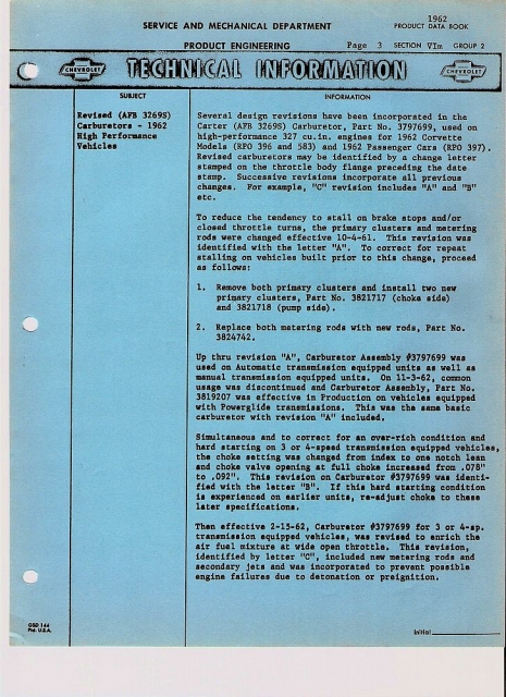

          • Verne Frantz
            Re: Example:
            Keith,
            Here's another example (I've posted before) that explains the revisions concept. I don't know what rev (if any) your original carb might have been up to by the time of your car's build, but as I said, it doesn't matter, as long as the date is correct for your car. "If" the carb with the right date just happened to be a service carb rather than a production carb, I don't think it would be stamped any differently at all. The 2 carbs should appear identical.
            I have no idea what the JM says or doesn't say about carb numbers.

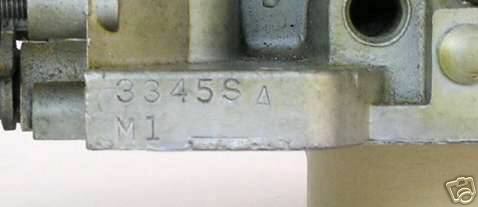

            • Verne Frantz
              Font
              An original AFB for your car would have a font like this one. Note that this carb was manufacturered Dec. '61 (M1) with no rev.
              • Keith M.
                • November 1, 1976
                • 205
                Re: Font
                Verne, your photo is what the judging manual says.Now are all these carbs I see with double numerical stampings serive replacements? Thanks
