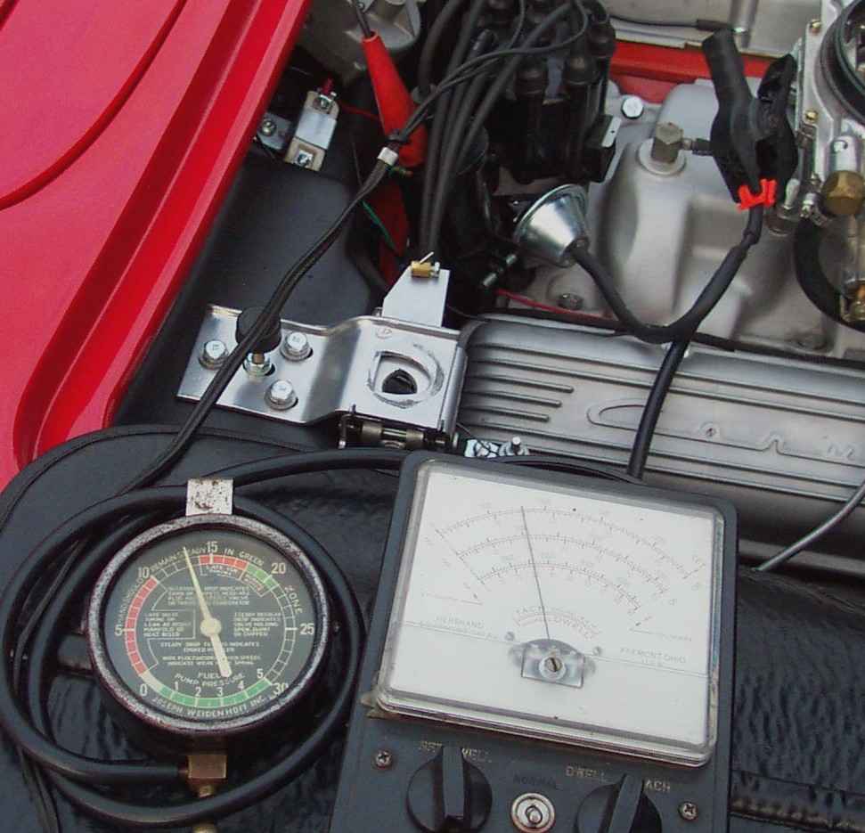

                  At about 900 rpm with the VAC (B26 VC1765) connected, the timming is not steady. It fluctuates slowly by a couple degrees on the tab. The vacuum is not steady either. It fluctuates rapidly between 14 and 15".
                  As soon as the vacuum drops below 14" the knocking starts. Or, drop the rpms below 900 and the knocking starts.
                  Then, I pinched the signal line a bit with a spring clamp. It's a miracle!
                  Duke's a genius, I was thinking. Knocking stopped, vac signal was steady.
                  I lowered the idle to 800 (below 750 the VAC would rattle) and the vacuum signal was a steady 13".
                  Next I removed the clamp and inserted a short length of smaller diameter hose inside the vacuum signal line for a restriction. So far so good, still no rattle. Disconnected my guages and went for a road test.
                  Not so good. The car jerks under light accelleration. I think the advance is comming in and out. With the vacuum now only pulling a steady 13" at 800 rpm, maybe the B26 isn't the best choice?
                  Tonight I will try the B28 again and leave the restriction in the vacuum line to steady the signal.
                  Thanks for all the help, I am learning a lot. Pat
