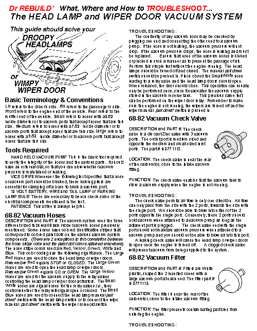

    There is a vacuum troubleshooting guide available at most Corvette online vendors.
    Web catalog of 2000+ pages, 1000+ illustrations, 12,000+ Corvette restoration parts available mail order. Dr Rebuild Corvette Products manufacturing & distributing reproduction parts for 1953-1982 models since 1979.
