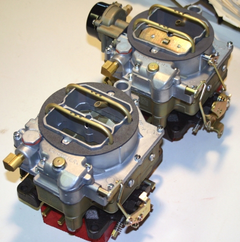

      • Dave Suesz
        C1 Carburetor Vent Tubes
        You mean these tubes? I dunno if it needs them, some WCFB carbs seem not to have had them.
        • Clem Z.
          • January 1, 2006
          • 9427
          Re: C1 Carburetor Vent Tubes
          this type of bowl vents were installed on WCFB carbs used on corvettes to try and prevent them from flooding out in sharp turns when road racing and autocrossing.
