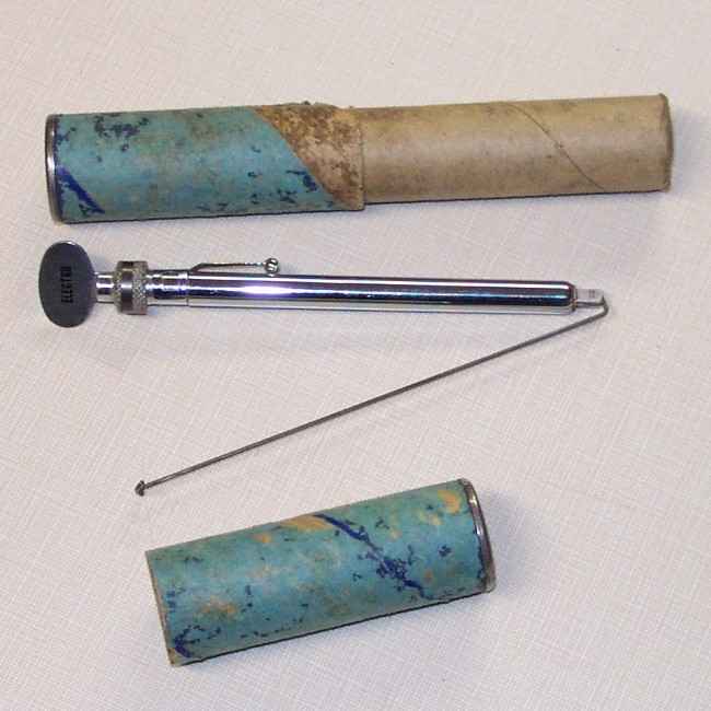

              • Pat #25912
                So that is what this is used for...
                It's been rolling around in my tool box for years.
