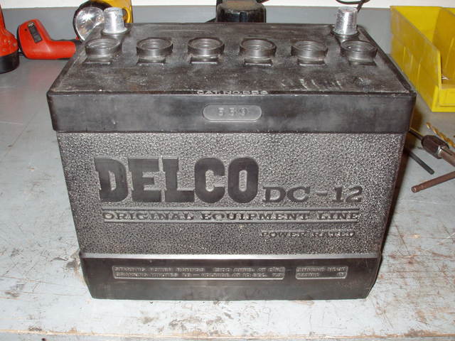

    I was wondering if there is any place that could build a R89 battery from an empty original casing? I have heard mixed things about the repro versions that have a battery inside a repro R89 case, so thought I would see if possible to have one built the way the original was made.

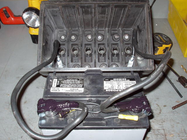

    I have seen a few cases where a member in search of points has removed the bottom of the case. I'm not sure how they did it but they installed a small battery inside that would start the car. They were proud of their work or no one would have known.

          I had found an original tar top that did not work. I cut the bottom out with a die grinder and slowly removed all the inners. Very time-consuming and messy. I drilled and taped the two posts from the inside and attached standard cables to them. A small but high amp Mazda battery fits nicely inside. This past Regional at Old Town I received full credit with no deductions.
