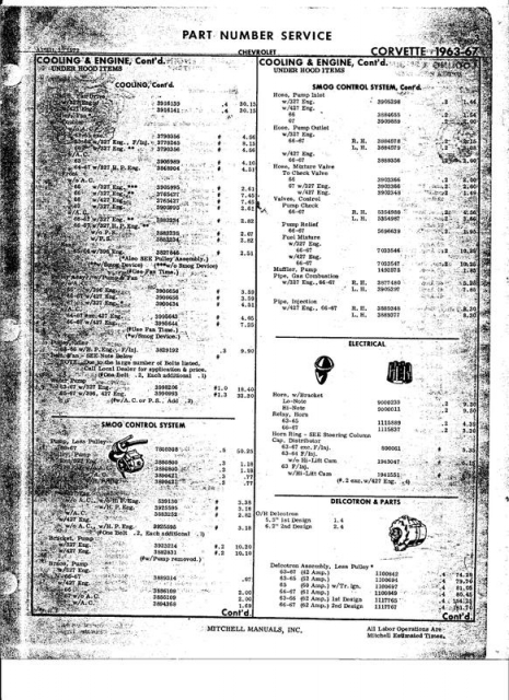

    Is there an existing recital of the components (by part #, etc.)of the 1966/7
    A.I.R. systems? Where can I find it? Thanks.

    judging manual. mike

      All the parts and part numbers are shown in the UPC K-19 sections of the 1966 and 1967 AIM's. The exceptions are the pump brackets. They are as follows:
      327-----GM #3882861
      427-----GM #3882831

        I can help and have a few lists. I started with '66 K19 equipment and some of the parts extend to '67's.
