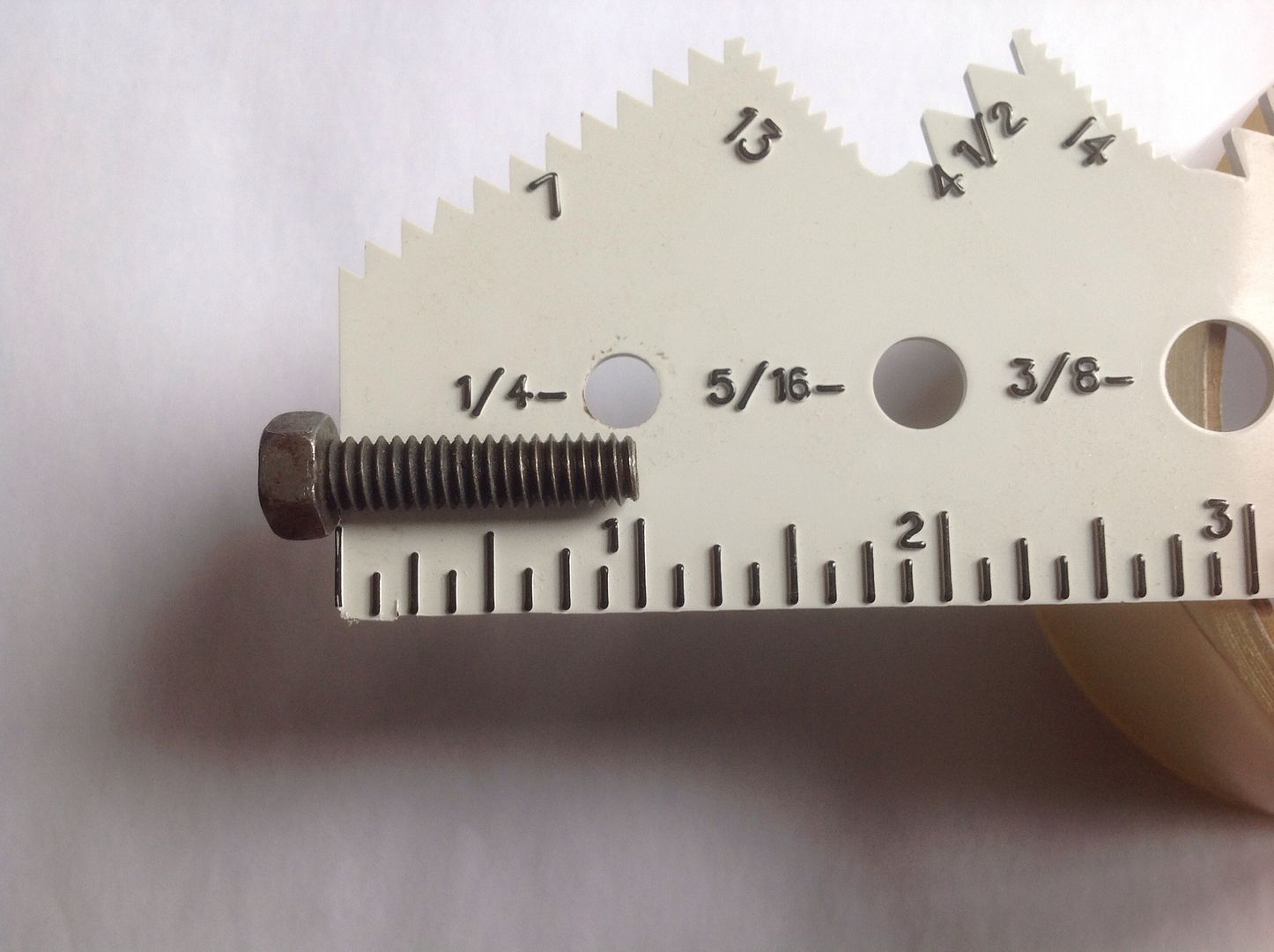

                        Michael, I removed one of the 8 bolts that attach the valve cover to the head, they all have the "R" stamp in them.
                        the one I removed is a 1/4 x 20 thread by 1 inch in length, I don't know if any of the others are longer, I didn't remove them.
                        Regards
                        Roy

                          Re: 1972 LT-1 valve cover bolt head markings
                          Thanks for checking that for me. Like I said beginning this thread, two of mine are missing but the remaining six are all "R". I checked another 72 LT-1, serial #18205, and all eight were "R". Now at least I know that's correct and what I need to look for.
