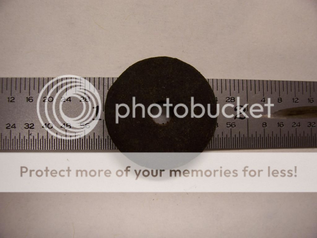

          Sure. Here's a picture of what the dealer sold me in 1980:
          This part is in group 12.183, part number 07583551. It measures 1/8 thick.
          I had to buy 40 of them!

            Bill, is the center hole 1/4".
            I could not find Group 12.183 on my 1933-1961 Parts & Accessories CD-ROM.

              Bill, how thick is the rubber washer? The center hole looks to be 1/4".
              Joe: 1/8 thick, hole is 1/8. Keep in mind that this part may not be exactly the same as the original part...

                3736275, 76 trim moldings, where 3723267 washer is used, are in Grp 8.132. My 29-59 P&A Catalog doesn't have that Grp 12.183 either. That group does not show the 3723267 washer there, nor is it shown in the Grp 8.899-8.991 Standard parts Section. Maybe Joe Lucia can gather some info about it. I'll drop him a PM.
                I suspect it may not have been available outside of production.

                  GM #3723267 was never available in SERVICE. I cannot find any specs on it from any source I have available.

                      I must have pulled that number off the AIM and put it on my long list of parts I was ordering without checking my parts book, because it sure isn't in my parts book. Some sympathetic soul at GMPD found a surrogate for me? Cool.
                      The ironic thing is that I won't use them. I never drive my oldies in the rain.
