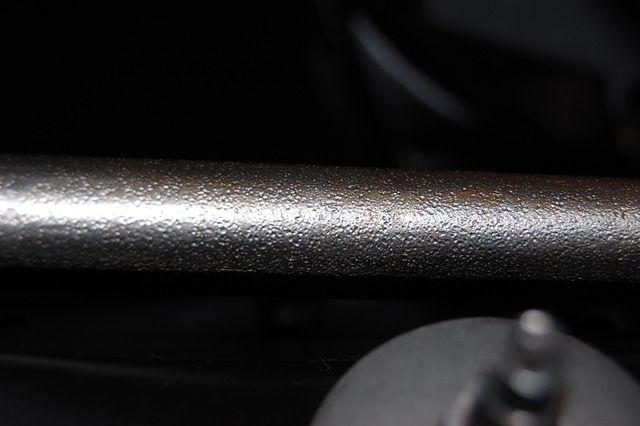

                          Re: 70 lt1
                          Hi,
                          Is this a shot peened finish?

                            Re: 70 lt1
                            Originally posted by Bill Chamberlain (47576)
                            All hail the great brotherhood of the Bernoulli Principle !!!
                            For without it - shipping packages across the great pond would take a very long time.......
                            ol' Danny Bernoulli was a nice guy. I think they lived just down the street from the Thud gang.
                            Kramden
