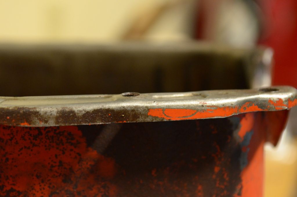

    This oil pan, as well as every other gasketed surface, leaked like a sieve before teardown. As I prep it for installation, I noticed that the bolt holes are heavily domed from the bolts being torqued down. I can flatten them somewhat going around with regular tip C-clamp. Is this worth the risk? Any other method to flatten out the bolt holes?

    You must flatten them. I usually do it by placing a block of hardwood under the holes and tapping them flat with a hammer.

      A block of wood - I feel a little silly for not thinking of that. Thanks Joe.

        And, then when rebolting, be aware of how tight you bolt up. I usually put all bolts in finger tight and then starting in the middle and working my way out, I tighten until snug and then and additional 1/4 turn.

            When tightening as said above, they will loosen as the gasket takes a set. I always do a retighten a few times until the stabilize.
            Most shops/dealerships don't have time to do it that way and only tighten once. Also if using a sealant it is easy to split the gasket at each bolt.
            I usually let the sealant set up before final torque. Everyone has their way of doing it but as Joe said tap each down, best done with the whole side of the pan on the flat surface.

              This is another advantage of using the one piece gasket. Each of the bolt holes is fitted with a compression-limiting "ferrule". So, the gasket is compressed by the exact amount required and the amount of torque applied to the bolts is limited. With this type gasket, no re-torque is required.
                  Agree. I use a ball peen hammer which works very well.
