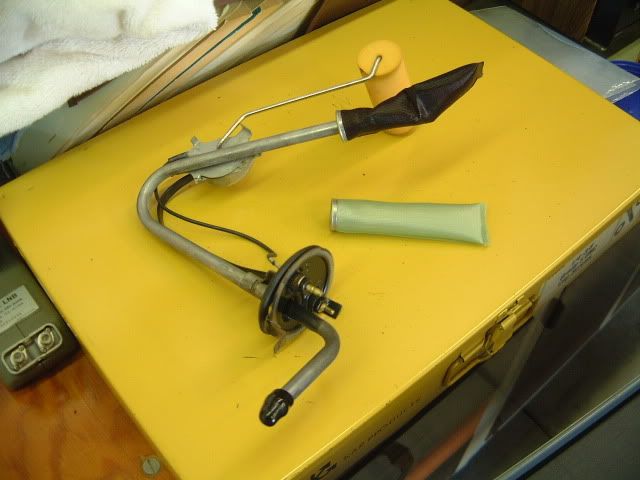

Attention Joe Lucia: Joe what application is this sender for-P/N 6425827 ? It sure doesn't look like the original one from my 64. Thanks in advance. Jack J.

Guys,
Here is a pic of an NOS 6425827 and an original from a 1964.
There IS no difference in the design but small differences in wiring and connectors.
Both work the same and read accurately.
JRDSCN4263.jpgDSCN4266.jpg- Top

Joe-------
The thing I don't understand about this is that the 6425827 was discontinued and superceded in 1968. So, I don't understand how any NOS example of the 6425827 could have a parts tag with a bar code on it as the one you pictured.In Appreciation of John Hinckley- Top
Re: Gas tank fuel sender
JR-------
I didn't say I was not convinced, I just said that I did not understand it. Apparently, the old part number was somehow "brought back" but I cannot figure out why.In Appreciation of John Hinckley- Top
