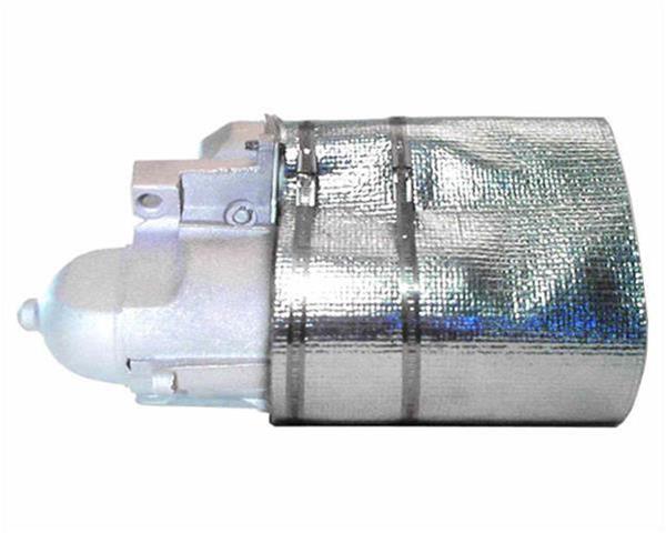

          I used a NAPA Heavy Duty solenoid and a aftermarket insulation wrap on the last 427 starter I replaced.
          This was after I had the standard solenoid on it. Because the starter is so close to the stock exhaust manifold, the standard solenoid plastic/bakelite cover had signs of melting.
          The insulation blanket seemed to help hot restart issues and prevented solenoid excessive heat.
          IIRC, this was the solenoid
          ECH ST-124
          This may have been the insulation....
          BKN HED8812
          or this one, I forget.
          Free Shipping - Thermo-Tec Starter Heat Shields with qualifying orders of $109. Shop Starter Heat Shields at Summit Racing.
          Rich
