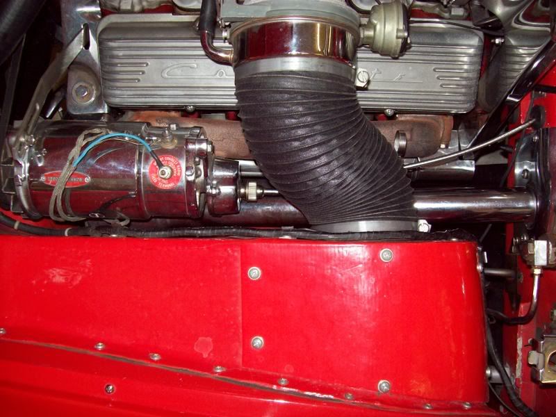

    In a nutshell, the airbox is a air intake box mounted on the left inner fender.
    See the airbox on the far side of the engine compartment in the photo below:

                Re: What is an airbox fuelie?
                And don't forget, there was one 56 airbox car. I know this to be a FACT, because it's in my garage!
                Also, it has a 265 that's been bored and stroked to 406 cubic inches.
                And here it is.
