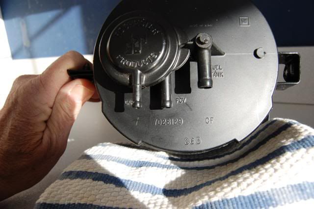

        Got it out this morning. Mine is exactly like yours. Date is 34. Car built February 27 1971
        any idea where to get the filter on the bottom?
        Thad

          Thad-------
          Very easy and inexpensive. GM #7026014, aka Delco A478C. About 2 bucks. Also available from other major filter manufacturers like Fram, Purolator, etc.
