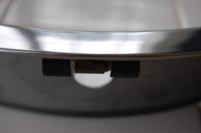

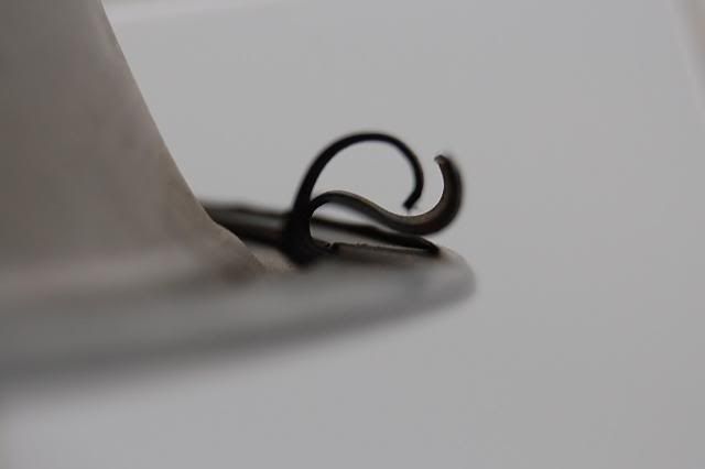

Hi Bill W,
Here's an example of a ring that left St.Louis on a 71.
'Clip' is spot welded in place on the band. No mounting 'prongs' on the clip as on later rings
'Layered' inner band, 'flat' in profile. Not shaped like an "L' laying on it's back as on later rings
'Crimp' around circumference of ring is smooth. Not wavy as is often an indication that the inner band was 'spun' to align one of the clips with the valve stem hole. Often done to rings available through service to make them appear as those used in production.
Hope this helps a bit.

I don't believe the "Wavyness" of the crimps has anything to do with whether the clip ring was rotated or not. I think it might have been an alternate manufacturing process, as I have seen un-tampered with examples of all three designs with wavy crimps. The only true indicator of an original ring, in my opinion, is the lack of inner lip as shown in Alan's photos- Top
Re: C3 Trim Ring Identification?
Sal, You are correct in reference to originality of the trim ring having the flat ring, but I think only when referencing the earlier shark cars (68-73)and maybe a little newer than 73. However, I think the later sharks had the flat ring with the turned up 90 degree "L" shaped ring.I don't believe the "Wavyness" of the crimps has anything to do with whether the clip ring was rotated or not. I think it might have been an alternate manufacturing process, as I have seen un-tampered with examples of all three designs with wavy crimps. The only true indicator of an original ring, in my opinion, is the lack of inner lip as shown in Alan's photos- Top
