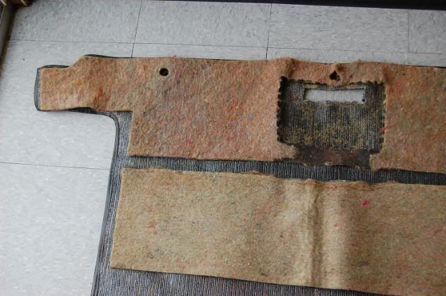

    I didn't find any evidence to indicate the black layer had a long term effect on the color of the jute underlayment.
    I did however find that the jute in the underlayment was quite different than the jute used on the firewall, transmission tunnel and upper back side of the seat bulkhead.
    71 not 70.
    Wheel well underlayment color. Note 'tight' texture.
    Rear compartment floor underlayment color.
    The jute on the upper back side of the seat bulkhead carpet. Notice 'loose' texture. Also note… this piece of carpet is unlike the rest of the carpet in the car…. it has NO backing on the carpet itself. Also notice the nice cut on the edge that was pushed down between the back of the seat bulkhead and the 3 compartment frame.

          Great pics once again. Amazing that they used 3 different jute types of Jute padding.

              IMHO I would take all the info Alan has provided in your other post and make your decision from there. His pictures tell the story.

                  It seems the unbacked carpet Alan identified on the bulkhead may actually have a VERY thin layer of latex. I spoke with a few different suppliers and you can still get the latex backed carpet in 80/20 loop. They all indicated the latex was needed to keep the carpet from falling apart as woven in manufacturing. The latex backing can be very difficult to see on black carpet but on the original green 70 80/20 loop carpet, that someone was kind enough to give me, you can see the black latex backing.
