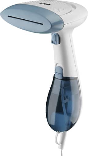

          Don, This is the one I use. Best Buy typically has them in stock at the stores.
          Conair GS23
          It's a hand held unit which makes it easy to use and quickly heats up for simple tasks. I use it for seat vinyl and soft top rags. It even works great for the soft top rear windows. For soft top rags I use it on both sides and it makes the wrinkles disappear like magic. Sometimes it takes several heat/cool cycles on the tough wrinkles. There are much more expensive commercial type units on the market but they're bulky and take up much space and take longer to heat up.
          On the '67 I recently restored, one of the vinyl seat backs was assembled wrong. The previous cover installer pulled the top vinyl too much on one side and the cover top to seat top was crooked. It was unsightly. I worked the hog rings to release the incorrect tension and all was better. However this left a soft crease from the incorrectly installed vinyl to the rear cover now exposed. Several steamer heat/cool cylces and a good rest on the shelf made the crease disappear. I'm quite certain that with some warm moist heat on your vinyl it will make your covers slip over your seat frames much easier.
