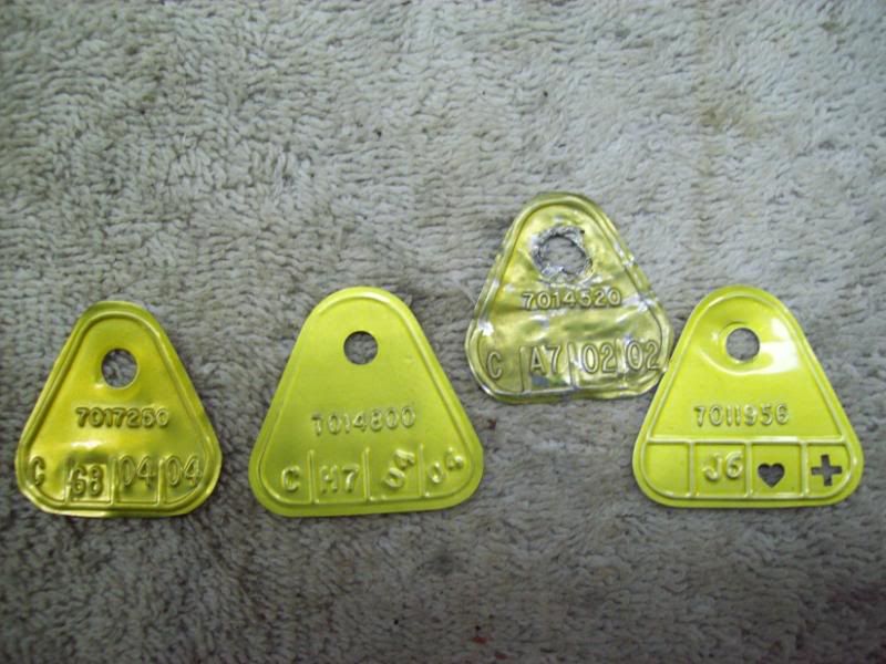

                That is NOT, repeat, NOT a 57 FI car, nor is the top shield (cover) a 57 shield.
                I don't know where that picture sprang up from (it is perfectly fine for you to use it), but that is my 56 Vette with a SB400, disguised to appear as a 57 FI 283 (to the untrained eye). The FI unit was once modified by Bill Thomas (heavily ported out) and is a conglomeration of 57-65 FI parts. So, I had my own unique plenum and fuel meter tags made up. The top shield is a repo I bought AT LEAST 30yrs ago. I think the top shield (repo) more closely resembles a 61-2 shield. The car is further disguised to resemble a 57 579D car with airbox, HD brakes/susp, dogdish caps, 4sp and posi. Although, I did keep the 56 Wonderbar and heater.
                Unique fuel meter tag, far right.
