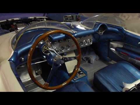

Yesterday I spent a few afternoon hours to reinstall the Fuel/Temp gauge pod, Ign switch(which had to come out to access it). It's pretty tight up there behind the custom cluster and my neck hurts but it was worth it.
Both Gauges now work properly. We're happy we were able to salvage the 2 original gauges.
I also had to install some thick gaskets for the 4 door pillar switches. Both Door Safety lamps and Courtesy lamps work better now that the switches are set outward a bit. I used thick ~1/8" cork and made them using a x-acto blade and my hole punches.
I have yet to install the safety fuses and will do that soon, but for now this concludes all of the electrical tests, repair and completion work. Starter and Generator/Regulator will be obviously tested before/during first start. I'll polarize the generator once the new battery goes in and hardwired. Soon to come.
