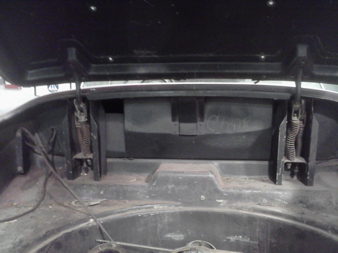

                    • 11608
                    Re: Restoration philosophy
                    In the trunk, the original color was written with a crayon or similar on the forward bulkhead just to the left of the right side hinge.
                    Remnants of that writing can often be found.
