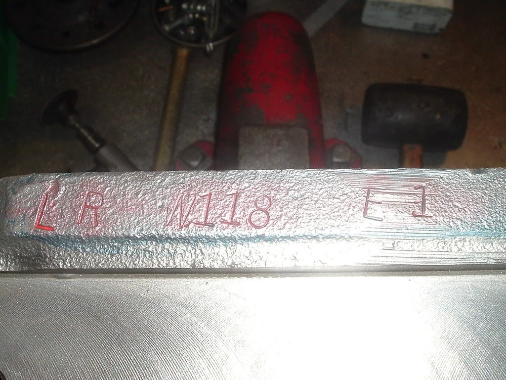

                    Here is the date code on a diff
                    Here is the stamping, which would be 1-2 months after the date code but that varied.

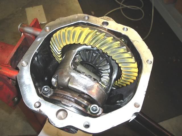

                    65-70 bearing caps look like this one- no cast in tab.
                    71-79 have the tab
                    63-64 caps were wider and had a tab
                      71-79 have the tab
                      Gary
                      You are amazing, and so kind. Nice going
