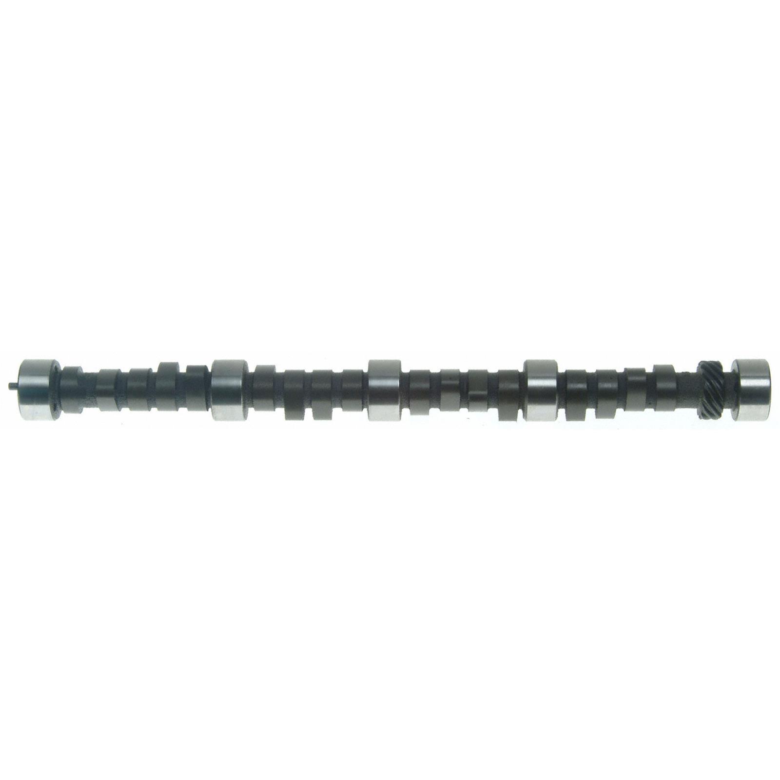

                            The Comp Cam version was Parkerized by your description. By pics on their respective sites they all look comparable but you can't see metal quality. I have another known "old school" engine builder in my area that I am going to consult before new cam purchase.
                            Has anyone had any experience with the lifters with the oiling hole in the bottom?
                            Comp Cams version-
                            https://www.compcams.com/factory-mus...k-396-454.html
                            Crane Cams version-
                            Sealed Power is now Speed Pro- Federal Mogul is now New Tenneco with no cams listed-
                            Free Shipping - Sealed Power Mechanical Flat Tappet Camshafts with qualifying orders of $109. Shop Camshafts at Summit Racing.
