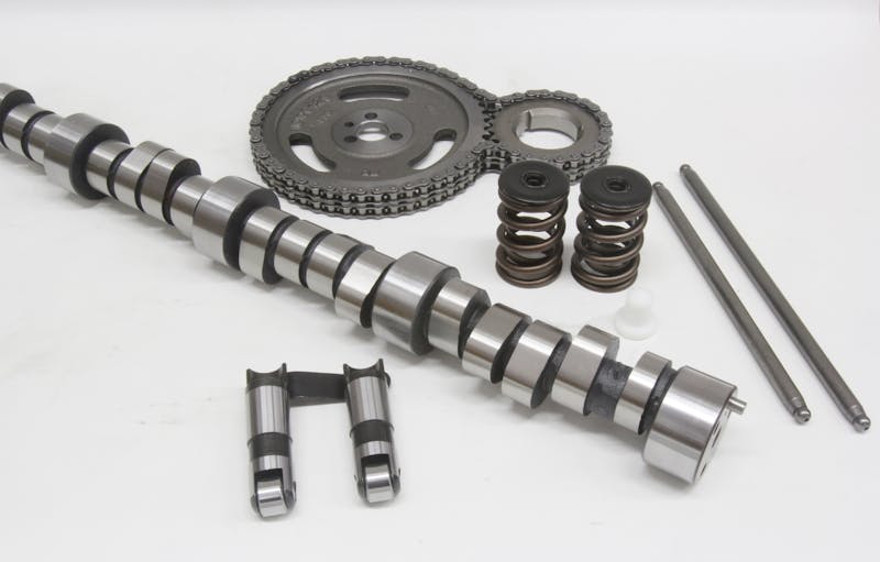

      Jack, my L71’s original OEM flat tapper cam lobes wore down significantly. So after much research and analysis I’ve decided to go with a hydraulic roller cam. Modern grinds make more power under the curve and there’s no more worrying about ZDDP. I’d bring it up with your engine builder.

        Chris - I've considered the hydraulic roller option, also recommended by another very experienced engine builder friend of mine. I'm not a novice, but these two guys are the proverbial forgot more than I'll ever know type of guys. Obviously it won't have that factory solid lifter sound for the purist (or for judging) but I drive my cars and I want to drive this one as well. I did not want to do this twice, and I sure don't want to do it three times. If much of what is available for flat tappet today is a high percentage failure rate I will go another direction out of necessity and forget the originality on this part of the build.
        It sounds like you have made the decision but have not acted yet? Have you identified a hydraulic roller cam with at least a similar to factory spec grind?

            • 48

            Thanks, I was hoping for an off-the-shelf solution rather then re-inventing the wheel here. Obviously I don't have the only engine of late with this issue. I'll be doing research and I'll post back what I learn.

              run headlight and wiper doors etc. So cam selection needs to factor in compression ratio, max rpm and vacuum. I haven’t selected a cam yet but I have decided to go with 10.0:1 compression ratio versus 11.1 factory. 11.1 rollers just don’t generate enough vacuum and there is very limited cam selection.

                  Jack, interesting article. Differences include longer stroke and oval port heads when compared to L71/72. There are really an infinite amount of cam choices out there including custom grinds. I’ve looked at a lot of cam catalogues and see trends for big Chevys using hydraulic rollers which I will dig up.

                    For reference, the Chevy Performance catalogue, which contains all their crate motors etc., has the ZZ427/480, which is marketed as a "modern take on the classic L88". It has 10.0:1 compression, oval port aluminum heads, and the cam is a hydraulic roller, 224/234 with 527/544 ex lift. LSA not listed. 480HP @ 6000 RPM, 490 ft-lbs @ 3800 RPM. So I'll probably going with something close to this.

                      Chris - You are a couple of steps ahead of me. In my research of hydraulic roller cams, a general consensus I was getting was that they are designed more for racing and therefore may not have longevity for street use. I know, everyone has a theory, but one knowledgeable person I trust told me the hydraulic roller cams were good for hard racing but not good for a lot of idle time. I thought that was one of the main reasons to go with a roller, which made me think of my friend who just recently bought a 502 crate engine for a large work truck from the catalog you cited, built by GM with a hydraulic roller and a warranty. I just asked him this week what was in that engine for a cam and why would't there be a similar modern version that could be used for my engine. He mentioned the catalog and we have not referenced yet but will be shortly. Thanks for you input.

                        Jack, whoever told you roller cams aren't for the street has been smoking something for a very long time. OEMS stopped using flat tappets in the 80s. Main benefits include reduced friction (mpg/horsepower) and reliability (no more worn out cam lobes).
                        Continue doing your own research. All the major cam companies have tech support who will give you recommendations. You need engine size, bore, stroke, compression ratio, car weight, manual or auto, tire size, etc. Crower did this for me recently.

                          Jack, your friend may have been referring to "solid" roller versus "hydraulic" roller. Yes solid rollers are generally used for racing (6500+rpm) and have aggressive profiles that require big spring pressures etc. For the street, generally, hydraulic is more appropriate. That being said, I know guys who run solid rollers on the street just so they can hear the ticking.
